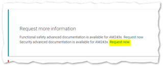

  • I'm no expert here but my guess is you need the OTP Key Writer. This is available in 'My secure resources' under your 'myTI dasboard'.
    If you don't have access, you can request it here:
    AM2434 data sheet, product information and support | TI.com
    Click 'Request now':
