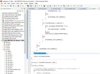

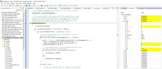

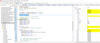

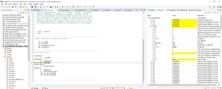

  • Hi Hu Jiangbo,
    I found the root cause for the issue!

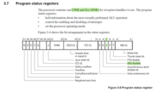

    The flag "I" in the CPSR register will decide the IRQ interrupt is in enabled state or disabled state.
    If this IRQ_disable bit is 1 means, then IRQ interrupts are disabled else IRQ interrupts are enabled.

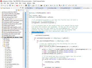

    Actually till before calling the function "taskENTER_CRITICAL" the IRQ_disable bit value is 0 only that means interrupts are enabled only, but once we call this function then the IRQ_disable value becoming 1 as it is a supervisor mode.
    But this flag is not clearing any where again and interrupts are in disabled state only.
    As we are entering into the critical section, so it is good to clear interrupts to eliminate the race around conditions:
    But again, after we exit from the critical section it would be good to reenable the interrupts:
    So, you can just call the "_enable_IRQ_interrupt_" after creating binary semaphores as below:
    This will reenable the interrupts, so our RTI interrupts will again work as we expected.
    Thanks & regards,
    Jagadish.
