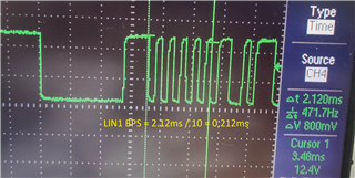

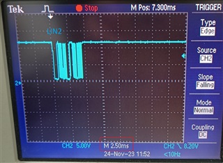

Customer try to write a program for dual LIN TX.
LIN1(B9/A9) & LIN2 (A8/B8) use same baud rate (19200) to shoot same 6 bytes data. Even we declare same baud rate parameter in code, but we found LIN1 & LIN2 is still base on different baud rate (clock) for data transmission. We not sure what's something wrong.
Capture graph as below,
The clock is not the same obviously!

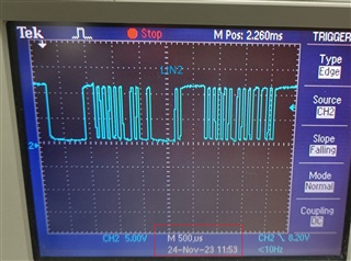

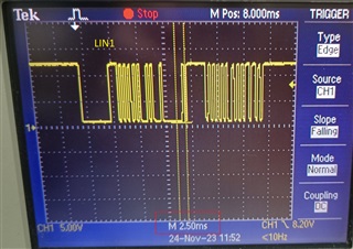

(1) LIN 1, 19200, 2.5ms/DIV
(2) LIN2, 19200 ?!, 2.5ms/DIV
(2) LIN2, 19200 ?!, 500us/DIV
Code as below.

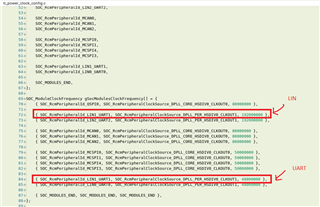

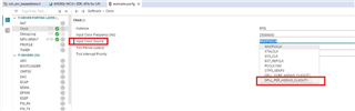

  • Hi Gibbs,
    Could you please clarify me that your facing this issue with LIN2 ? LIN1 we see the right baud rate is it ? or both LIN1 and LIN2 are generating different baud rates ?
    And also I did the analysis on the code seems okay to me. Basically the baud calculations as showed in the snippet.
    Flinclk = Fvclk/16(P+1+(M/16))
    Based on the configurations from code M=0, P=624 and Lin module clk should be 192Mhz to achieve 19200 bits/sec baud rate.
    Since both codes are same, my only suspect is that what is the input module clk for both instances.
    From TRM we should be selecting this: DPLL_PER_HSDIV0_CLK OUT1 --> PLL_PER_CLK: HSDIV0_CLKOUT1 --> 192MHz
    With divider value of zero. Could you please confirm me that you have this configuration right for both LIN1 and LIN2.
    We should be doing this from MSS_RCM SRC_SEL and DIV_VAL registers for that particular LIN instance individually.
    If possible, can we get the 192MHz probed in both the cases, just to make sure there is no issue with PLL and HSDIVIDERs.
    Kindly, please do let me know if we can have a debug session if everything mentioned above are correct and still the issue was there.

  • Hi, Kantha Rao
    Thanks your replies.
    Base on oscilloscope display, I am not sure which one (LIN1/LIN2) correct runs19200 bits/sec baud rate(Do you Know?).
    But the result tell us LIN1 and LIN2 are generating different baud rates base on same configuration in code, so we may try to identify why it happens?
    I believe(guess) LIN1 should be run 19200 bits/sec correctly, because we reference SDK sample code.

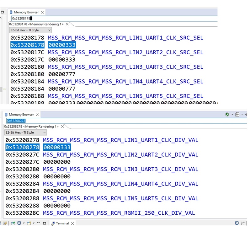

  • Hi Gibbs,
    Even i'm also not clear from the snippets attached!
    Before we go there, lets first make sure that input clk to the both instances are correct.

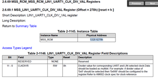

    MSS_RCM is the main sub system reset and clock manager, we can refer the MSS_RCM register space for configuring the LIN1 and LIN2 src and div values to get the right input clocks. Mostly this can be done through either sysconfig or from the code.
    When your running the application can you pause and see these register values.
    0x53208178  --> this is MSS_LIN1_CLK_SRC selection
    0x5320817C --> this is MSS_LIN2_CLK_SRC selection
    0x53208278  --> this is MSS_LIN1_CLK_DIV selection
    0x5320827C --> this is MSS_LIN2_CLK_DIV selection
    ideally based on the clock planner we should be reading LIN1/2_CLK_SRC value as: 0x00000333 and LIN1/2_CLK_DIV value as: 0x00000000
    kindly, please do check them on mem_browser in CCS and let me know. If needed please do setup a call so that we can have active debug session to understand better.
    Kantha Rao

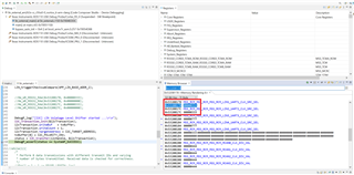

  • Hi, Kantha Rao
    Sorry, I make a mistake for debugging
    Basically, I do not need to add these command to correct MSS_LINx_CLK_SRC & MSS_LINx_CLK_DIV value
    Default value is correct!
    Result show as below.

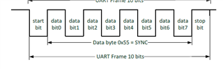

  • Okay, If this is the case we should be seeing right baud value.
    One doubt how are we measuring the baud rate here. Basically in LIN header we have sync field.
    As i can see in the waveforms attached in the snippet seems like the above image. Can we measure what is the width between sync field pos edge and neg edge. ideally we should be getting 52.0833us if the baud rate is properly set.
    This will be deciding our baud rate in LIN.
    Could you please analyze the waveforms one more time for Sync Field.
    Kantha Rao

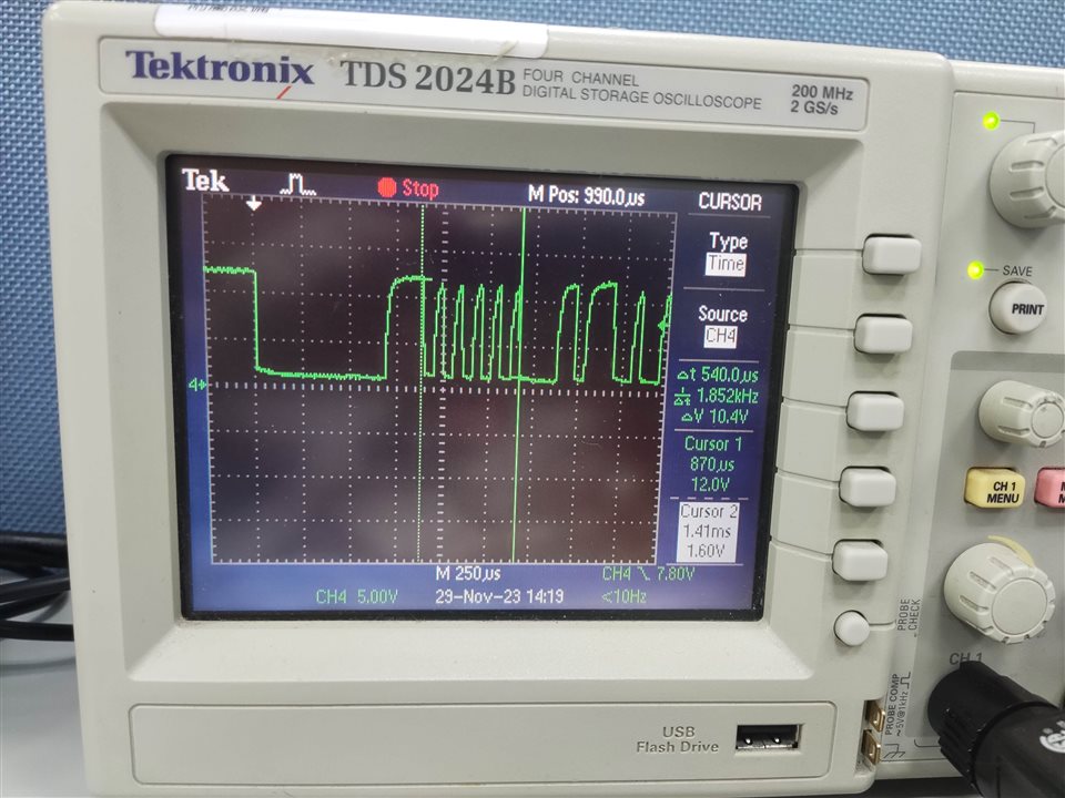

  • Thanks, Kantha Rao
    Because customer board is not on my side, so wait customer measure feedback.
    replies will be a little bit delay
    Gibbs

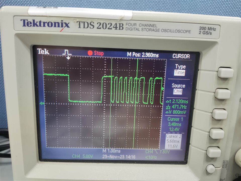

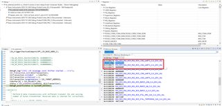

  • LIN1 port waveform
    LIN2 port waveform
    Register Setup:
    The MSS_LIN1_CLK_DIV value is different, how to check this setup on CCS?

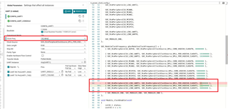

  • Hi Gibbs,
    As i mentioned earlier this MSS_RCM register configurations can be done either through sysconfig or through the direct register write i suggested add in the code in one of the above replies.
    Seems like in your application this had done through the sysconfig only. Could you please click on sysconfig in the application and check the LIN driver configurations.
    Assigning to Punit from the SW team who can help on this.
    Kantha Rao

  • Hi, Kantha Rao & Expert
    Let's me make an information sync, if something wrong, please correct me.
    1. LIN1 & LIN2 Both have wrong baud rate base on same code setting.
    Base on LIN Bus Sync Field (0x55), each bit should be 52us for baud rate 19200 bps. I already use AM26CC EVM to make a double check, sample code project (lin_external_am263x-cc_r5fss0-0_nortos_ti-arm-clang) works correct for LIN1, but I can not measure LIN2 because of NO LIN2 interface out. You can find LIN1/LIN2 baud rate are both wrong for customer's board. (Should be?!)
    2. Wrong MSS_LIN1_CLK_DIV value.
    We know use hard code register setting "HW_WR_REG32_RAW" to modify MSS_LIN1_CLK_DIV = 0, but it always return value 0x00000333 on customer's board. I also duplicate the experiments on AM26CC, I found I also can not modify MSS_LIN1_CLK_DIV value even use direct register setting, I Is it any lock  mechanism for this register?
    Basically, MSS_LIN1_CLK_DIV is only setting by function "LIN_setBaudRatePrescaler(APP_LIN_BASE_ADDR, 624U, 0U);", not in pinmux.
    3. WUCPUCLK source for LIN1 & LIN2
    As you mention before, LIN1/LIN2 use DPLL_PER_HSDIV0_CLK OUT1 as input clock source, but I found default sample code use WUCPUCLK for pinmux. Is it a problem?!
    4. Different AM26x device.
    Customer use part AM2634CODFHMZCZRQ1, not superset device. Any difference?
    Need your all possible debug suggestions, include HW & SW check.
    Many Thanks
    Gibbs
  • Hi Gibbs,
    Point 3:
    To achieve 19200 bps we should be feeding DPLL_PER_HSDIV0_CLK_OUT1 to both the lin instances, since customer source clk is WUCPUCLK baud rate is not achieved. This has to be changed in the generated code SW team will help on that.
    Point 2:
    May be the MSS_RCM lock had been there because of that you couldn't be able to modify it.
    Point1:
    As you mentioned in Point 3, due to wrong input clk and also div value for one instance make to feed to different input clocks to both LIN instances.
    So, due to this we have seen wrong baud rates.
    I spoke to the SW expert he will be helping on how to modify the generated code for the right configurations.
    Kantha Rao
  • Hi Gibbs,
    The issue customer is seeing because the module clocks of LIN and UART are same, and the customer is using UART1 with input clk freq 48 Mhz. So, the module clock configuration of UART1 overides the LIN1 clock configuration. To avoid this issue, you can suggest him to change the input freq of UART1 clk to 192 Mhz .
    The UART module requires a 48MHz clock. To configure UART to work at this frequency, I recommend configuring the Divisor Latch Low (DLL) and Divisor Latch High (DLH) registers internally within the UART module.
    By adjusting the DLL and DLH values, we can efficiently derive the desired 48MHz clock frequency from the 192MHz input clock. This way, we ensure that both UART and LIN receive the same clock signal while allowing for internal division within the UART module to meet the specific requirements.
    Please let me know if you have any questions or if further clarification is needed.
    Abishek S S
  • By modified the UART1 clock Freq setup as 192 Mhz, the LIN1 and LIN2 could generate the same data waveform,
    Many thanks for your help.
  • Many Thanks your help,  Abishek S S / Kantha Rao
