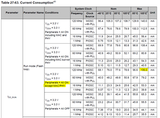

    I don't think there will be a problem to support the above. I will suggest you also look at TM4C (e.g. TM4C129) MCU which is the same silicon as MSP432Em but has more part numbers to choose from a features vs costs perspective.

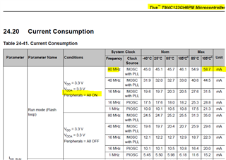

    MSP432E/TM4C129 does not come in 64-pin PM package. If you are looking for 64-pin, please look at TM4C123 which also supports USB 2.0 and GPIOs

    You can find the current consumption and the thermal characteristics of the package for TM4C MCU in the datasheet
    TM4C123:
    TM4C129:
