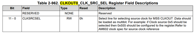

How to verify the core clock frequency is 400Mhz?
Is that any clockout PIN or Register is available to verify?

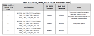

the maximum frequency supported for SYS_CLK is 200MHz. You can find configuration details in Table 6-22. R5SS_CORE_CLK:SYSCLK Achievable Ratio of the TRM

We have got an other query, what is the difference between R5SS Core clock Frequency and SYS Clock Frequency ?
Is the code/SW execution based on R5SS Core clock or SYS Clock ?
Hi Javish,
R5SS clock is the main processor clock uses internally, which makes it the clock used for code execution
SYS_CLK is a derived clock from the above and it is mainly used for interconnect, hardware accelerators, and various peripherals
