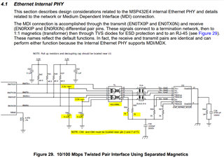

I have designed a board that does not have a working LAN. The power supply is OK and the MCU works, but the LAN does not work. Attached is the schematic of the MCU and the LAN.
Do you see any reason why the LAN is not working?
Framed in red box I show some stubs that I have in the pcb. The stubs are different (they are not symmetrical) with a maximum length of 16mm and width 1.524mm.
Framed in red box I show the passive components of the LAN connector. I have used this same schematic in another project (not with MSP432) and it works perfectly.
Please, check the MSP432.pdf file with the shematic

    Note this difference in my design compared to the MSP432E401Y LaunchPad:

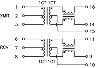

    The MSP432E401Y LaunchPad uses a transformer (HX1198FNL T) with the filter on the side of the chip, in my case I used a transformer (HR641680E) with the filter on the side of the RJ45 connector. But this shouldn't be a problem, or am I wrong?
    My board:
      Please refer to section 4.1 MSP432E System Design Guideline for best practices. The transformer in the design guideline has the same orientation as yours so I think it should be fine from that perspective. As you are already aware the recommended transformer is HX1188FNL showed in the TRM and HX1198FNLT implemented on the LP. This is not to say you cannot use HR641680E by similarity. It will be good to check with the manufacturer for their assessment of suitability. One thing I notice on your schematic is that the center tap is not filtered but rather connected to 3.3V only. However, I don't know if this is what caused the Ethernet to not work. Please refer to the design guideline on the center tap connection. I will suggest you probe the differential pairs and compare between LP and your board to see if it will reveal any hints.
    The center tap of the transformer (microcontroller side of the transformer) should be connected to 3.3 V. Each connection point to the 3.3-V rail must be adequately filtered with a capacitor (0.1 µF or greater) if a solid power-plane is present (C40, C60 in Figure 29). If the center tap connects to a PCB trace instead of a plane, the capacitor value should be 1 µF or greater.
