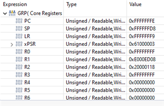

  • Hi Charles,
    Based on boot_serial_emac_flash example and your comment about the 32-bit values, I have created a minimal project which for now only calls the essential part of CallApplication with the image selection and other features to be added once the image switch will be working.
    In CallApplication, I have set VTABLE_START_ADDRESS 0x20000000 and APP_START_ADDRESS1 0x00080000. I have compiled the bootloader and the actual application as bin file and I have tested the bin of the application to work fine in case copied to the beginning of the flash.
    Using Uniflash, I have uploaded the images to the device:
    So, for testing purposes, I have 2 copies of the same firmware at 0A000 and at 80000.
    My expectation would be that the bootloader starts and then replaces itself by the application located at 0x00080000. I can debug through the bootloader code until the end, i.e. "bx r0" and it all looks good. However when I would expect the main application to start, I get a JTAG error "CORTEX_M4_0: Can't Run Target CPU: (Error -1268 @ 0x1090001) Device is locked up in Hard Fault or in NMI. Reset the device, and retry the operation. If error persists, confirm configuration, power-cycle the board, and/or try more reliable JTAG settings (e.g. lower TCLK). (Emulation package 9.12.0.00150)" and the disassembly view goes to nowehere:
    As in order to not to overwrite the bootloader in operation, I had to copy the vector table to 0x20000000, do I need to change anything in the build settingo the application?
    Peter
  • Hi Peter,
      Your first screenshot is unviewable.
      In Uniflash, you can load the bootloader, your firmware1 and firmware2 all at once provided you provide the correct offset so that Uniflash knows where to program the two firmware images. Also the firmware1 must be  linked to 0xA000 during build time and the firmware2 must be built and linked to 0x80000.
      If you look at the boot_serial_flash_app2 example, the application is allocated to 0x4000 during build time.
