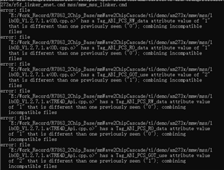

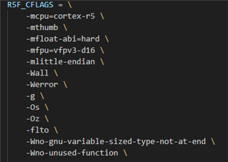

外部库使用和工程相同的编译工具及参数,如下:
但是在调用API的时候会如下报错:
请问出现这种情况是还有哪些编译参数没有同步导致的吗?

    If the APIs are compiled with different attributes, for example RW or RO static data is allowed to be addressed absolutely, you will get error if your project only allow PC-relative addressing. I am not an expert of compiler/linker.

    2. The external library or APIs are some Back-end algorithm we custom write. The compile param is as same as mmw project like picture above.
    Thanks for your reply.
  • Hi -- The values used for those build attributes are correct with respect to what the tiarmclang compiler supports by default; you would only expect to see incompatibility errors if your project was being built to expect PC-relative addressing, as QJ states.  This would be the case if your project was being built with "-fpic" to enable position independent code, but "-fpic" is not included in the list of options you provide.  Can you double-check the build of your project to make sure that "-fpic" is never included in the list of build options?
    Also, do you see the same errors if you remove "-flto" from the compile and link step?

    I have checked the compile params, the -fpic option was indeed added. When I remove this option the program compiled success and run fine.
