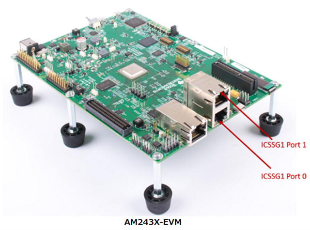

    3. The following connections are made.
    EtherCAT IN ・・・ Master
    EtherCAT OUT ・・・ Other slaves
    Kanae

    Can you tell me If the connection is in similar way:
    When evaluating with our custom board, let us explain the circuit diagram that we sent you.
    -Master on EtherCAT IN side
    -Other slaves on the EtherCAT OUT side
    When evaluating with TI-EVM
    -Master on ICSSG1 Port0 side
    -Other slaves on ICSSG1 Port1 side
    Nilabh said;
    Which master are they using.
    The master is TwinCAT3 from Beckhoff.
    Kanae

  • Hi Nilabh,
    Thank you for your support.
    The customer verifying this issue has reported the information as follows.
    The problem that the OUT side of EtherCAT cannot communicate has been solved.
    The cause is due to the difference of HW between TI-EVM board and custom board.
    TI-EVM board ・・・ Link status signal output from ECAT PHY side is input to CPU side.
    Custom board ・・・ The above signal is not input to the CPU side.
    The following is an explanation using the schematic diagram provided the other day,
    TI-EVM board ・・・ LED (LINK) signal of PHY is input to CPU.
    Custom board ・・・ LED (SPEED) signal is input to CPU instead of LED (LINK) signal of PHY.
    I modified the custom board and replaced the LED(SPEED) signal with LED(LINK) signal,
    and now the OUT side can also communicate.
    Although the details are still unknown, it seems that the CPU judges the Hi/Low status
    of the PHY link status signal and controls whether the OUT side communicates
    or not according to the Hi/Low status.
    It is thought that the modification enabled the CPU to judge Hi/Low status,
    so that the OUT side communication is now possible.
