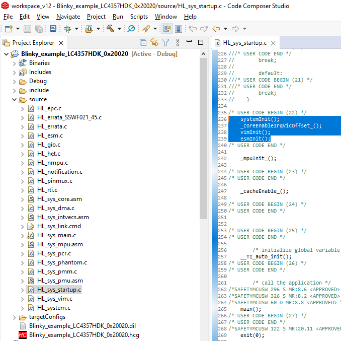

  • Hi WonBin,
    However, the application code I need to use is behaving abnormally, which is why I asked for help.
    I think it's a configuration error in the part related to the vector using interrupts in the application.
    I am suspecting one thing as root cause!
    Actually, in application code startup file also (like bootloader) we will read the reset cause and based on that we will execute the initialization functions
    You can see that if the RESET cause equal to the POWERON_RESET, DEBUG_RESET or DEBUG_RESET then only we are executing the functions like "systemInit" and "vimInit".
    But here the problem is this, actually before application reading this reset cause first bootloader will read the reset cause right? What this bootloader will do is after reading the reset cause, it will erase the reset cause.
    So due to this when next time application reads the reset cause it will read the "NO_RESET" instead of actual RESET.
    And this will skip all the initializations("systemInit" and "vimInit") related to the application and code will directly enter into the default state and exit from there.
    Because of this your application code interrupts will not work and also pin configurations etc in application will not work.
    So, my suggestion would be this, add all the initialization functions in application code to the " USER CODE BEGIN (22) " like as shown below.
    Now our initialization functions will work irrespective of the RESET cause.
    Thanks & regards,
    Jagadish.
