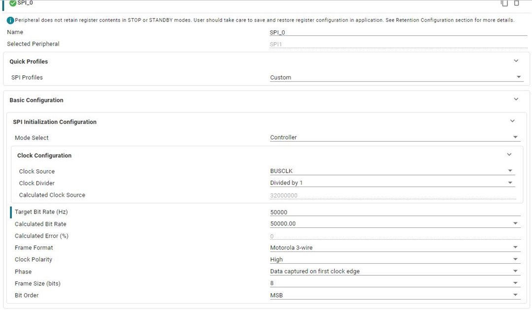

  • hi Arthur,
    I have setup CC115L with MSPM0 using SPI macros that given in the per_test. please see blow forum https://e2e.ti.com/support/wireless-connectivity/sub-1-ghz-group/sub-1-ghz/f/sub-1-ghz-forum/1302202/cc115l-cc115l-interface-with-mspm0/4945562#4945562 I have posted in the wrong dept.
    main problem was one of our legacy receiver not received paring message and relay on message.
    I want to know the SPI clock frequency that used in the SPI_periperal_eco_interrupts example? and how I can modify the SPI clock frequency. It may be an issue hopefully.
    Staneslouse
  • hi Arthur,
    I really need a  SPI example to initiate command like thins  cc1101SpiWriteReg(preferredSettings[i].addr, &writeByte, 1);
    Is there any matching example is MSPM0 SDK?
    Kind regards
    Staneslouse
  • Hi Staneslouse,
    Have you had a look at the spi_controller_register_format_LP_MSPM0G3507_nortos_ticlang example? From the MSPM0 SDK?
    You should just plug those calls into the cc1101SpiWriteReg, instead of the old MSP430 register calls.
    Arthur
  • hi Arthur,
    I have rewrite code to configure CC115L & transmit some data, unfortunately It doesn't transmit accordingly. could you please advice me on this, here with attached the code.
    PHY - OOK/433/2byte sync
    SPI settings also attached.
    Kind regards
    Staneslouse

  • Hi Staneslouse,
    Do you meant the CC115L does not transmit correctly or you are not seeing proper SPI communication with the device?
    Brandon Fisher
  • Hi Brandon,
    I have correct some of chip select sequence and now I can see proper SPI communication, but radio not transmit correctly. when look at the above interrupt loop, CC115L should transmit pair message 3 times but I can see when I press the switch couple of time the pair message detected by our legacy RF product.
    I used DL_SPI_isBusy(SPI_0_INST) to check before transmit next byte but unfortunately it not working.
    Kind regards
    Staneslouse
  • Hi Staneslouse,
    If you are migrating a legacy setup, do you still have access to old hardware from the end of the communication channel you are replacing, and did it also use the C115L?
    If so it might be worth it to probe both the old and new SPI traffic on both sets of hardware to see if there are any notable differences in command structure/sequence.
    Brandon Fisher
  • hi Brandon,
    unfortunately we are migrating from Atmel for both micro and radio.
    Kind regards
    Staneslouse
  • Hi Staneslouse,
    Is the sequence of commands you are sending still the same as in the above code?
    When you say you've observed correct SPI comms, was this validated on a logic analyzer or Oscope?
    Apologies if these questions seem redundant, I'm just trying to narrow down whether the issue is on the C115L side or the MSPM0 side.
    If you have a capture of the whole sequence that would be helpful as well.
    Brandon Fisher
