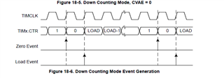

I used timerG of MSPM0 with setting as below.
Timer clock source: LFCLK
Timer clock divider: 1
Timer clock prescaler: 1
Timer mode: One-shot Up Counting
Below is code example to test TimerG and output log

    while (1)
Output log
[Test 1][Timer not started] counter11 = 0, counter12 = 0, runFlag11 = 0
[Test 2][Timer started] counter21 = 0, counter22 = 32, counter23 = 196, counter24 = 525, runFlag21 = 1, runFlag22 = 0
[Test 3][Counter reach max value] counter31 = 525, counter32 = 164, counter33 = 16383, counter34 = 16383
[Test 4][Set counter value before start] counter41 = 10000, counter42 = 164, counter43 = 328
[Test 5][Get counter value] counter51 = 328, counter52 = 164
I expect that I will get counter value from 0 after calling DL_TimerG_startCounter().
But if DL_TimerG_getTimerCount() is called immediately after calling DL_TimerG_startCounter(), it seems that TimerG need some times to reset counter to 0 and then start to increase counter value (counter31, counter41, counter51 are not 0).
Do I need to add the delay after start the timer (for TimerG resets counter value) before calling DL_TimerG_getTimerCount()?
How much time do I need to delay?
