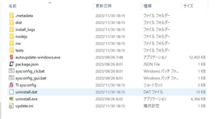

- "TI sysconfig (shortcut)" in "C:\ti\sysconfig_1.18.0" cannot be started

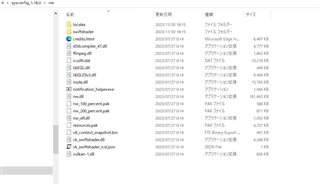

・"nw.exe" does not exist in "C:\ti\sysconfig_1.18.0\nw"
