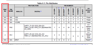

I'm trying to create a simple program to configure GPIO on our board. I'm planning on creating a bare bones program without using Driver Lib (using it as a sort of a reference though). Looking at the overview for the GPIO module it looks like the starting point is the creation of the GPIO_PinConfig array, with each element corresponding to a pin on the MCU.
I have some questions on this listed below:
  1. What happens to pins that are multiplexed?
  2. The documentation has no description of IOMUX module and how it interplays with this one. Can you help me with it?
  3. Example GPIO projects in Code composer studio (CCS) always start with configuring the IOMUX module before it actual starts working with GPIO registers. This isn't reflected in driverlib documentation. Am I missing something here?
  4. What happens in case of different pin configurations? Each of them have a different GPIO count now isn't it? Shouldn't this be reflected in the code as well?

  • Are you planning to not use SysConfig either, or just Driverlib?, because obviously SysConfig uses DriverLib.
  • I plan to NOT use DriverLib as a distinct library. I am merely consulting the DriverLib src code to get a feel for the register bank and similar things and then create . Which is why I am not very clear on the approach here regarding IOMUX usage.
    Could you expand a bit on my doubts above please?
  • 1. For the MSPM0, it use PINCMx to reconginze and configure the related IO.
    2. For MSPM0, it use IOMUX to control the IO and select the functions.
    3. Another improtant thing on MSPM0 is that it treat GPIO as a peripheal. It is always Peripheral 01 for output or input mux.
    4. If you want to use register to coding, you need to look deep into the TRM.

  • Just that you need to rewrite SysConfig Init, if you want to eliminate driverlib entirely
