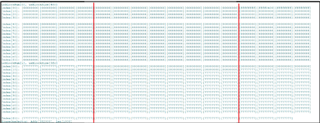

Customer side found Flash read content sometimes not right (after Flash read, they immediately do CRC check on the content and failed). They tried 3 methods to solve the issue: 1. disable EDMA, no problem anymore; 2. disable cache, also no problem anymore; 3. adding 5us delay after Cache_inv in QSPI_edmaTransfer function, no problem found anymore.
Based on the above observation, I hypothesize that this issue may be caused by cache coherency problem. Since customer immediately used the data after Flash read, and maybe Cache_inv operation needs more time to finished, and before that if CPU read to the buffer it will use the old value in the cache but not the updated one. I compared the buffer result with the Flash content, found that the correct values are aligned at 32-byte which is also the cache line size.
Need your double confirmation on above analysis and please check internally with the design team that if cache_inv needs some time to be finished and if it is, please also give the needed time.

  • Please check the below wrong result from Flash_read. The 2 buffers are initialized to 0x66666666/0x77777777. The Flash read contents only updates some locations (32-byte aligned).
