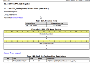

    I gather there is something called the efuse, baked into the EEPROM (or is it the chip itself) at manufacturing time, that contains this configuration information.
    EFUSE is a small ROM in the SOC (AM263x)chip which has one two address for CPSW(as it is a 2 external port switch), it is part of SoC itself. It is different from EEPROM Kindly see the following section of register addendum.www.ti.com/.../spruj42d.pdf
    My Questions: How do I create my own efuse/storage for this information? How to I point the generated code to this custom efuse? How do I find the relevant MAC information and ensure it is discoverable/readable by the sysconfig generated code?
    You can always do a register read to get the mac address from EFUSE

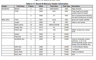

  • I am working with rivrats and we've read the EEPROM and received 255 in every frame. Could you share what we expect in EEPROM on the dev kits? Not just MAC address but entire EEPROM contents would be great. Thanks.
  • Hi Michael,
    I did not find details on exact contents of EEPROM in AM263x device. But you can find a similar info on AM243x BOARD ID _EEPROM table of MA243x launchpad kit. You may need to make changes in sw as the offset may not be similar on both dev kits(although content remains similar)
    Please refer to the USER guide of dev kit section: 4.6.2 Board ID EEPROM
    https://www.ti.com/lit/ug/spruj12e/spruj12e.pdf
