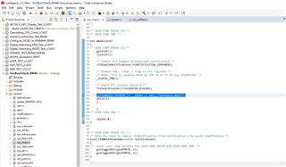

Dear all,
After s
etting RESET1(bit 15) in System Exception Control Register (SYSECR)—
causing a system software reset—the MCU initialization `FMCECCCHECK_FAIL1` test is failing—which tests for successful correction of a 1-bit error on flash.
Is this behaviour expected?
Thanks for your time and support.
With my best regards,
Luis

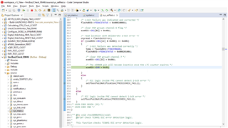

  • Hi Luis,
    You mean, is your code executing below highlighted line after reset in "fmcECCcheck" function?
    Can i get any simplest project with this issue, you are talking about?
    Thanks & regards,
    Jagadish.

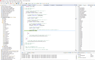

  • Hi Jagadish,
    Sorry for the delayed response.
    Yes, our code is executing the highlighted line after reset in "fmcECCcheck" function.
    In our application code we integrated the HALCOGEN generated code related to MCU initialization as-is (no functional modifications, only minor modifications to enable unit testing).
    I tried to insert the HALCOGEN project files but for unknown reasons the upload starts but immediately fails. I just posted at the end of this response the content of the `sys_selftest.c` used as part of our application.
    In concrete terms—within the application, at some point after MCU initialization that uses the HALCOGEN generated code—the code used to set the SYSECR bit is below in the following snippet:
    `*sysecr_reg = (uint32_t)1U << 15U` with `#define sysecr_reg ((volatile uint32_t *)0xFFFFFFE0U)`
    Sorry for the project files inconvenience. Is the information provided sufficient to help you answer my question?
    Thanks for your time.
    Luis

    I don't have TMS570LS1227 board, so i tried to test your issue on RM46 and i created a project as per your data.
    fmcBus2Check_RM46.zip
    And here i am not seeing the issue you are mentioned. The code never ends up at FMCECCCHECK_FAIL1.
    Can you please check my verify my code and guide me if i miss something.

  • Hi Luis,
    I opened the project and tried to figure out where in the project my original question is verified, and I can't figure out where (file and line) the RESET1(bit 15) in System Exception Control Register (SYSECR) is set.
    Could you please point me to the file/line where the bit RESET1 is set, or if it is not the case, the rationale behind the code in sys_main.c you provided—w.r.t. the original question about SYSECR bit set?
    I didn't add the RESET code, i just tried by resetting from debugger it self. Can you please confirm that, can i add the reset code on main loop?
    I added in main function before calling while(1) and still i couldn't reproduce the issue you are talking about. And behavior was same.
    Thanks & regards,
    Jagadish.
