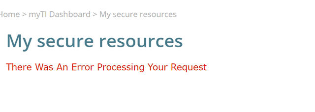

Hi Pavel,
Sorry for the delay. I will check it on high priority.

Hi Pavel,
Can you check the access now? MCAL package will be ASIL D safety compliance in 09.01.00 release and same will be certified.
