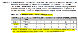

I have modified the ssi_quad_mode example project to print 'Q' 'S' 'S' 'I' on SSI2. I receive the correct signal on three data lines, however it appears SSI2XDATA2 (pin PD7) does not output a signal. I have attached a snapshot of a scope capture of these lines:
DIO2 captures SSI2Clk, PD3
DIO1 captures SSI2XDATA3, PD6
DIO0 captures SSI2DATAX2, PD7
DIO4 captures SSI2DATAX1, PD0
DIO3 captures SSI2DATAX0, PD1
I have ran a continuity test from my scope input to pin 42 on the X11 header on the evaluation board, and from my scope input to pin 128 on the MCU, both are fine. In addition, I have ran this code on another separate evaluation board and received the same results. Below, I have attach the code, keep in mind this was adapted from the ssi_quad_mode example project found in the TivaWare package:
