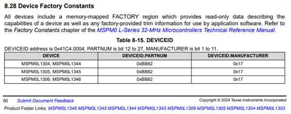

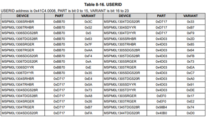

I have a customer that because of security reasons, wants to identify a unique number for every MSPM0 device.  From reading through the TRM, there are 3 registers that seem to provide this information: TRACEID, DEVICEID and USERID.  However from reading these registers from 3 different LPs, I'm not making sense out of one I am getting.  For example, from the 3 LPs that I am using, see below:
Device #1:
TRACEID:  0x00000000
DEVICEID: 0x1BB8202F
USERID:     0x80C2DDD3
Device #2:
TRACEID:  0x00000000
USERID:     0x80C2BB70
Device #3:
TRACEID:  0x00000221
USERID:     0x80C2BB70
From reading through the documentation in the TRM about these registers, it's not clear how these values I am getting map to the bit fields in the registers.  Can you explain what is going on here in more detail and exactly what bit fields uniquely identify a device so that the customer can come up with a value that uniquely identifies a particular device?  In particular, is it the TRACEID and the PART field of the USERID register that uniquely identify a device?  It is not clear what is the meaning of the TRACEID and the VARIANT and PART fields of the USERID register and how these relate.  Can you provide more details here?
