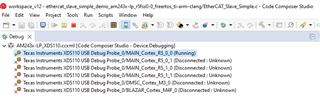

LP-AM243 set up as in documentation, CCS12.? running, can download code into LP-AM243, can start code.
LP-AM243 is set up as EtherCAT Slave with Kunbus simple example (ethercat_slave_simple_demo_am243x-lp_..._freertos).
Code ist built, Target is connected, reset, program loaded and started.
Terminal Output of the LP2434 in CCS seems OK, the version printout of OSAL etc. is shown.
Ethercat is managed by CoDeSys, RTESoftmotion project is setup, internal RTE PLC in the PC is started,  EtherCAT master is added and connected via the Gateway.
For verification a normal IO-Box from Murr is connected and shows up in the device list if scanned, if Ethercat is started the Murr device is showing green on the EtherCAT project in CoDeSys.
If the LP-AM243 is hooked up on the EtherCAT a device scan on the master DOES NOT SHOW UP the LP-AM243, ESI-descriptions are imported already in CoDeSys.
Green LED on the network-socket of port0 of the LP-AM243 is on, LED 12...15 are walking.
The CCS-Project (terminal output) shows that the application completes an state switch from 0 to 1 so that the application on the AM2434 would wait for a connection.
