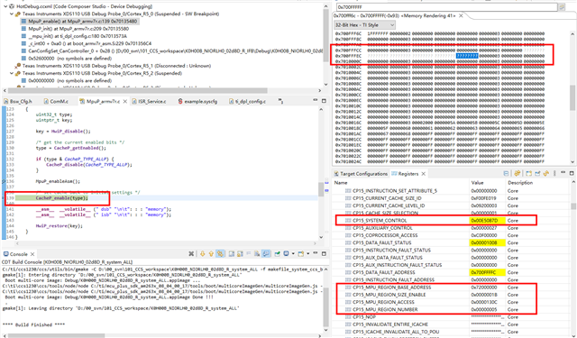

AM2634: After the MPU is configured, the memory cannot be accessed
Part Number: AM2634
During the debugging process, it was found that when the code is executed to the "Mpup_enableAsm", the address of the 0x700FFFFC will be inaccessible, can you help analyze the reason for this problem? Thank you!

/* ----------- MpuP_armv7 ----------- */
#define CONFIG_MPU_NUM_REGIONS  (6u)
MpuP_Config gMpuConfig = {
    .numRegions = CONFIG_MPU_NUM_REGIONS,
    .enableBackgroundRegion = 0,
    .enableMpu = 1,
MpuP_RegionConfig gMpuRegionConfig[CONFIG_MPU_NUM_REGIONS] =
        .baseAddr = 0x0u,
        .size = MpuP_RegionSize_2G,
        .attrs = {
            .isEnable = 1,
            .isCacheable = 0,
            .isBufferable = 0,
            .isSharable = 1,
            .isExecuteNever = 1,
            .tex = 0,
            .accessPerm = MpuP_AP_S_RW_U_R,
            .subregionDisableMask = 0x0u
        .baseAddr = 0x0u,
        .size = MpuP_RegionSize_32K,
        .attrs = {
            .isEnable = 1,
            .isCacheable = 1,
            .isBufferable = 1,
            .isSharable = 0,
            .isExecuteNever = 0,
            .tex = 1,
        .baseAddr = 0x80000u,
        .attrs = {
            .isEnable = 1,
            .isCacheable = 1,
            .isBufferable = 1,
            .isSharable = 0,
            .tex = 1,
        .baseAddr = 0x70000000u,
        .size = MpuP_RegionSize_2M,
        .attrs = {
            .isEnable = 1,
            .isCacheable = 1,
            .isBufferable = 1,
            .isSharable = 0,
            .tex = 1,
        .baseAddr = 0x50D00000u,
        .size = MpuP_RegionSize_16K,
        .attrs = {
            .isEnable = 1,
            .isCacheable = 0,
            .isBufferable = 0,
            .isSharable = 1,
            .tex = 0,
            .accessPerm = MpuP_AP_ALL_RW,
        .baseAddr = 0x72000000u,
        .attrs = {
            .isEnable = 1,
            .isCacheable = 0,
            .isBufferable = 0,
            .isSharable = 1,
            .tex = 1,
