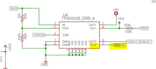

     I am using the TM4C1294NCDPT launchpad unable to debug the program.
/*CORTEX_M4_0: Error connecting to the target: Unable to communicate with the device. Please check your connection. */
During working in pwm program.
Next what we ca do !!!

      Is this the first time you are trying to connect to the LaunchPad or it has been working before until today?
      If the LaunchPad has been working before, then do you know what is the latest program that is currently in the flash? Is that the stock TivaWare pwm program or some other program you had modified? If you modified the program then what did you modify?
      I will suggest you first try to unlock the device and see if you can recover the chip. See below screenshot and Unlock the device to its factory setting,

    In this line i will change the 10 <=> 100
    Using LM Flash programmer  unable to erase it.....
    Next  what we can do ?
    Thanks and Regards
    Aravind.SR
      Please refer to this post for details. https://e2e.ti.com/support/microcontrollers/arm-based-microcontrollers-group/arm-based-microcontrollers/f/arm-based-microcontrollers-forum/345762/tiva-c-series-tm4c1294-connected-launchpad. The problem is that PQ4 is driven by the TPS to indicate OC (over current) to the MCU. When configuring PQ4 for DIVSCLK, it messes up the TPS and affects the ICDI emulation. Please either the cut the trace to the OC signal or remove U4 as mentioned as the workaround in the post if you really need to use DIVSCLK in the future for your application. If you have a custom board, this problem may not affect you depending on your use of PQ4.
