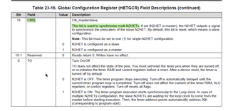

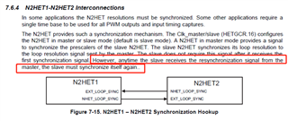

In the TMS570LC4357's manual, there is the following function about 2 N2HET resynchronization. How to configure the master to initiate a resynchronization signal to the slave?

It is simple, in two N2HET instances you just need to SET CMS bit in one N2HET instance and need to RESET CMS bit in other N2HET instance. The SET CMS bit N2HET will act as a master and provides the synchronization signal to the RESET CMS bit N2HET instance which will act like a slave.
There is no other external connections or configurations required for this synchronization. If you don't want synchronization between two instances, then you just need to set CMS bit in both the N2HET then both will act like a master's and operates independently.
