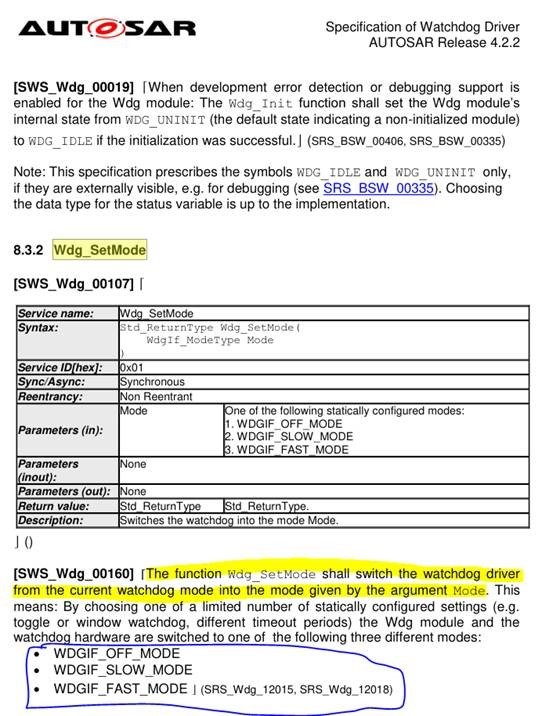

    Could you please let me know when 'WDGIF_OFF_MODE', 'WDGIF_SLOW_MODE', 'WDGIF_FAST_MODE' will be implemented on our WDG MCAL driver as specified in autoSAR standard?

  • Hi Harshit, Sunil,
    My customer concerned how they can set watchdog mode to 'off' in programming session or in entering sleep sequence if 'off_mode' is not supported and mode can't be modified while running. Could you please let me know how they can set watchdog mode to 'off' in programming session or in entering sleep sequence?

  • Hi SI,
    Please find the answers for the above queries you had.
    1. Regarding WDG Set Mode Implementation
    [Sunil] Wdg driver cannot support Wdg_SetMode feature due to hardware IP limitation. Please refer below for more details.
    Please refer section 13.5.1.4.1 RTI Digital Windowed Watchdog in below user guide.
    Configuration of DWWD: The DWWD preload value (same as DWD preload) can only be configured when the DWWD counter is disabled.
    Please refer section 4.19.29.1 MEM_RTIDWDPRLD Register in below user guide.
    2. Watchdog IRQ implementation
    [Sunil] Please refer [SWS_Wdg_00166] in below SWS specification.
    The routine servicing an internal watchdog shall be implemented as an interrupt routine driven by a hardware timer
    Also please refer section 9.2 Data exchange between watchdog driver and hardware.
    https://www.autosar.org/fileadmin/standards/R4.3.1/CP/AUTOSAR_SWS_WatchdogDriver.pdf
    We have removed  wdt_irq.c in MCAL v9.0.1 because to comply with above requirement as wdg internally does not support interrupt.
    Application has to call watchdog service routine  'Wdg_Trigger' provided in Wdg.c in the interrupt routine driven by a GPT timer.
    3. Regarding 'off_mode'
    Unfortunately Wdg cannot be set to OFF mode during runtime due to hardware limitation as mentioned in the 1st point above.
