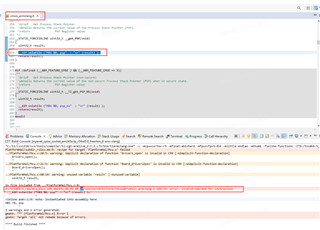

Now that the code is running in the R5 core, how can I obtain the value of PSP? I used the code shown in the figure below, but compilation cannot pass. It seems that the compiler doesn't recognize PSP. How can I obtain the value of PSP pointer?

Hi guxl24,
I assume you intend to read the SP which is at R13.
You can simply use "str" to store the same to a variable with intrinsics.
I hope this solves your problem.
