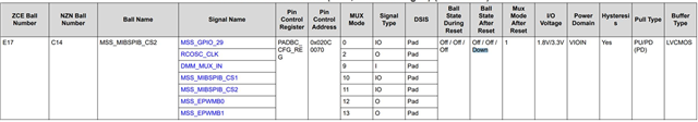

I was wondering if it is possible to manage SOP[1] /E17 internally( code/software) by putting this pin always to low level(pull down)?
In my hardware this is not mapped and I need to configure it internally to pull down.

Hi, E17 pin after reset is pulled down. Extract from DS:
So by default its pulled down (SW can also configure in case needed later). Hope this clarifies your query.
