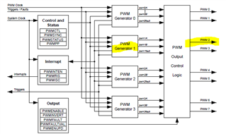

I had a quick question about the PWM Modules. How would I know when I have to choose GenA or GenB in Generator#? Is it based on the output port# I will using?
Example, I want to use PORTA6.
Would I use Module1, PWMGenerator1, GenA?
Or let's say, PORTE5.
Module0, PWMGenerator2, GenB?
      Please refer to the datasheet PWM signal list and PWM Module Diagram. As you can see for PA6, you would be using PWM Module 1 and Generation 1 so that PWM2 signal is output on PA6 pin.
  • Seeing this diagram, is it possible to use either A or B generator with either generator#? or as they specially assigned by the port output?

  • is it possible to use either A or B generator with either generator#? or as they specially assigned by the port output?
    I'm not clear with what you mean. You can use PWM generator 1 to control pwm2 and pwm3 outputs. What are the A or B you are referring? There is no A or B generator on the diagram. Don't get confused with the A or B comparators.
