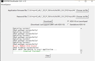

Hi Team,
There's an issue from the customer need your help:
Factory_reset.pdf
My environment isCCS Version: 12.5.0, uniflash, development versionLP-MSPM0G3507
SDK= mspm0_sdk_1_20_01_06
I have abslquestion
Gasho Factory_reset.pdf 做Uart bsl Time ,Use MSPM0_BSL_GUI.exe
LP_MSPM0G3507_PB27_Toggle_demo_app.txt --> The example can be used
AC2_GLA.txt --> Our own can also be used
But I want to switch to BSL Inside UART feet
I open the sample program
bsl_uart_flash_interface_LP_MSPM0G3507_nortos_ticlang
No changes in content,Only tickserase main and nonmain memory
The following error occurs during burning
CORTEX_M0P: GEL Output: Memory Map Initialization Complete
CORTEX_M0P: Error: (Error -1001 @ 0x0) Requested operation is not supported on this device. (Emulation package 9.13.0.00201)
CORTEX_M0P: Trouble Halting Target CPU: (Error -2064 @ 0x0) Unable to read device status. Reset the device, and retry the operation. If error persists, confirm configuration, power-cycle the board, and/or try more reliable JTAG settings (e.g. lower TCLK). (Emulation package 9.13.0.00201)
CORTEX_M0P: Error: (Error -614 @ 0x0) The target indicates there is an error condition from a previous SWD  request. Clear the error the condition, and try the SWD request again. (Emulation package 9.13.0.00201)
I restarted and tried againMSPM0_BSL_GUI.exe
AC2_GLA.txt --> An error occurred

q
I have to use Factory_reset restore again to proceedbsl
Can I ask which step needs to be adjusted??
if any, Please advise me.
Ben
  • Hi Ben,
    Due to the UART plugin will use the main flash from address 0x1000 to 0x3000. So the application code should avoid this area, they can refer to this cmd file as reference
    https://e2e.ti.com/cfs-file/__key/communityserver-discussions-components-files/908/mspm0g3507.cmd
  • Hi Gary,
    But why can bsl burning be performed successfully after using factory reset?
    I want to know first about the action of factory reset. Is it equal to the action of bsl_uart_flash_interface_LP_MSPM0G3507_nortos_ticlang project?
    Ben
  • After factory reset, the secondary BSL is erased and the static write protection on the secondary BSL area are removed due to the configuration NVM also be erased and write with default valules, that is why it will success after factory reset.
