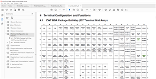

  • iam working on  ADC in controller tms570ls4357  using example code in halcogen
    example_adcDisplay.c   for this  if  if  i will temperature sensor  output  to ADC0  will it  work  sir ,  any information related to this if u have please provide me sir
  • Hi Jeev,
    Apologies for the delay, i am on vacation for a week.
    In ADC example they are using ADC pin 0 and ADC pin 1.
    And they will be on W14 and V17 on the controller.
    Thanks & regards,
    Jagadish.

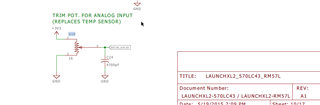

  • dear sir  in controller TMS570LS4357  as  potentiometer  ADIN_6  for analog input  through that we cannot give analog to  ADC sir
  • IC U10  in controller  shall i use that one for analog signal
  • what  sir  no reply  for  last question
  • i ask  if  follow  above  example sequence  which u mention   it  f enough   to convert  analog  to  digital  , that i asked
    Yes, follow the above-mentioned sequence. That is enough.
    Yes, you can use this potentiometer.
    You no need to do any further connections here, as you can see potentiometer already connected to AD1IN[6], you just need to enable corresponding channel and do the conversion. If you want to change the analog input to the ADC then you just need to manually rotate the knob of the potentiometer, if you do that the analog input to the ADC will vary and so that you can also see the changes in the corresponding digital output as well.
    Thanks & regards,
    Jagadish.

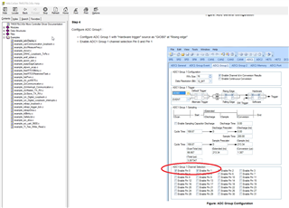

  • Dear  sir ,  i try  to  get ADC  through example code  of ADC  to know  what type of output  it will come , what value will   be  store in  register  after enable  the channel 6  for  Analog input  from potentiometer ,  but  it struct in adcisconvertcomplete() ,  not  moving  forward .  what will be issue sir , kindly reply fast sir
  • Hi Jeev,
    Please verify your code with "adcDisplay" example in HALCoGen, make sure you are following all the steps mentioned there. The code should work.
    Thanks & regards,
    Jagadish.

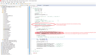

  • Dear  sir  ,  same code nothing change  and  i followed   whatever they  mention in example code , and i enable  pin 6 channel of  ADCgroup1 . for analog input  of  potentiometer .
  • dear  sir , we using  GIO  only  for hardware trigger , its means  in  Gio port i enable  direction pin ,that's all sir,
  • Hi Jeev,
    I created a example project for your requirement:
    AD1IN_6_ADC_Display_Test_LC4357.zip
    I tested this project and it is working as expected.
    You can see the docklight data for channel-6 before adjusting potentiometer and i also captured by rotating potentiometer knob
    You can see after i rotating knob into anticlockwise, my digital output got reduced. I did this testing on my Launchpad board.
    Please compare your project with my project and do the necessary changes.
    Thanks & regards,
    Jagadish.

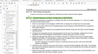

  • dear  sir default  reset control register is 0, if  i check value present in G1EMBUFFER = its giving 214789516  like its giving in operation control register is 40 in second array . if every are default by writing same thing what is use sir , is  they some other way
  • Select the channels that need to be converted in Group1 by writing to the Group1 Channel Select Register (ADG1SEL). In this example, a value of 0x115 needs to be written to ADG1SEL in order to select channels 0, 2, 4, and 8 for conversion in Group1
    Wait for the GP1_END bit to be set in the Group1 Conversion Status Register (ADG1SR). This bit gets set when all the channels selected for conversion in Group1 are converted and the results are stored in the Group1 memory.
    7. Read the conversion results by reading from the Group1 FIFO access location (ADG1BUFFER) or by reading directly from the Group1 results’ memory
    sir  instruction is understood sir , due to that getting wrong  can explain that with example please sir
  • i cannot understand  above instruction sir , getting confuse , can u explain  sir ,
    thank you
  • dear  sir ,  any  update
  • ok sir ,  no  problem  i will  handle this one, thank you for ur support thank you
  • Hi Jeev,
    You don't need any separate example to understand this, if you go through the example code carefully you can find all those steps in detail.
    As you can see, we are doing same steps in example code. Just go through their definition understand how they are using the registers.

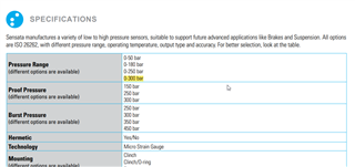

  • dear sir ,  from  brake pressure  of  railway ,  using  pressure  sensor ,  that output i will give to controller   by converting   ampere  output   into  volt  output , range  is  between 0- 3.3v , how to convert  that  , can u help me sir
  • Hi Jeev,
    Map your pressure sensor input with its output.
    For example, my pressure sensor will monitor the pressure in the range of 0 to 300bar. That means pressure sensor will give the 0v output to ADC for 0bar pressure and will give the 3.3v output to the ADC for 300bar pressure.
    I guess you already know how to convert the ADC digital result to the analog input right?
    Analog_value = (3.3 / 4096) * DigitalResult
    The above formula is for 12bit ADC and considering ADREFHI = 3.3v and ADREFLO = 0v.
    And after calculating analog value in your code for equivalent digital result and now you can convert the analog value into the pressure using below formula
    Pressure = (3.3 / 300) * Analog_value
    The above formula is so simple, the pressure sensor will give 3.3v for 300bar pressure right so in my code i got some analog value so that i am calculating the pressure for corresponding value.
