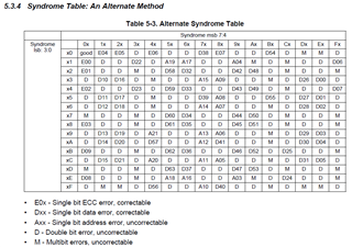

    5.6.2.6 ECC Data Correction Diagnostic Mode 7: DIAGMODE = 7
    Testing the error correction and ECC logic in the CPU involves corrupting the ECC value returned to the
    CPU. By inverting one or more bits of the ECC, the CPU will detect errors in a selected data or ECC bit, or
    in any possible value returned by the ECC.
    To set an error for a particular bit use the syndrome, see Table 5-3. For instance if you want to corrupt
    data bit 62 then put the value 70h into the test register.
    The method uses the DATA_INV_PAR value in the FPAR_OVR register to alter the ECC during a slave
    access cycle. The value in the DATA_INV_PAR register will be XORed with the current ECC to give a bad
    ECC value to the CPU. This only will occur when the DIAG_MODE is 7, the PAR_OVR_KEY is 5, the
    DIAG_EN_KEY in the FDIAGCTRL register is 5 and the access is a slave cycle.
    This mode can set the FEDACSTATUS status error bits ECC_MUL_ERR or ERR_ZERO_FLG but it will
    not set D_UNC_ERR nor D_COR_ERR. Also the logic to support the ECCx_MAL_ERR and
    COMx_MAL_GOOD bits is not implemented for the CPU path so these bits will not set.
    The sequence to do this test would be:
    1. Make sure the true DMA module is off.
    2. Put 0101b into PAR_OVR_KEY and 101b into DAT_INV_PAR fields (00005Axxh) of the FPAR_OVR
    register (0x7C).
    3. Put the desired value in DAT_INV_PAR field of FPAR_OVR register.
    4. Put 7 in DIAG_MODE, and 5 in DIAG_EN_KEY of FDIAGCTRL (0x6C).
    5. Do a slave access of the desired address.
    6. Put 0 in DIAG_MODE or A in one of the key fields to turn off this test.
    7. Check error registers for ECC errors. (0x14, 0x1C, 0x20).
    8. Repeat as necessary to test out the ECC.
    9. Put 0 in DIAG_MODE and A in both of the key fields to completely disable this test at the end of the
    test.
    10. Write 5400h to FPAR_OVR(0x7C) to clear DAT_INV_PAR and put 2 into PAR_OVR_KEY.
