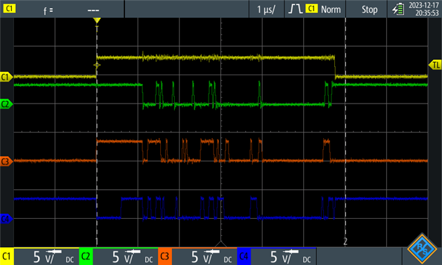

We are trying to use the CPSW example with RGMII2, but it does not work.
Using the example, we forcibly assigned an IP and checked Link Up and Network Up in the log.
However, no packets are received or transmitted.
When we check the port sent from DP83869 to AM2434, we see the Rx signal and RXC signal, but there is no content in AM2434's UDMA memory for ENET.
Please help us.

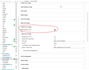

    3. What exact modifications have you made to use the RGMII2?
    load example and We removed unused parts from our custom board.
    Remove eeprom, io expander(i2c), DDR.
    use syscfg below.

    Is there a partner for MAC Port Number and RGMII1 or RGMII2?
    Because Custom Board only has RGMII V2 port activated.
    When the same firmware is used for the EVM and Custom board, the EVM is assigned to MAC Port2 and the Custom board is assigned to MAC Port1.
    Can you please elaborate this?
    Please note that RGMII2 pins are connected to MAC Port 2 and RGMII1 pins are connected to MAC Port 1. This cant be interchanged.
    If your PHY is connected to RGMII2, then you have to disable MAC Port 1 and keep MAC Port 2 only in syscfg-gui tool,
    Relevant screen shots of syscfg to configure MAC PORT2 only wit RGMII2
    Thanks and regards,
    Pradeep
