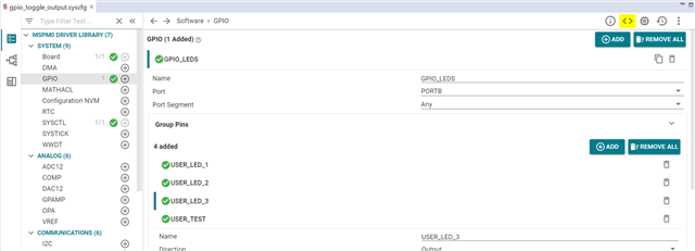

    Looking at your SysConfig file, I see that all your GPIOs are on Port B (PB).

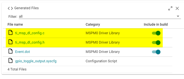

    If you look at SysConfig there is a symbol on the top right <>
    From here you can click on the ti_msp_dl_config.c and ti_msp_dl_config.h files
    These are the generated files that sysconfig will create. The .h has #defines for pseudonyms to allow you to code using names that pertain to your application, rather than exact register names.

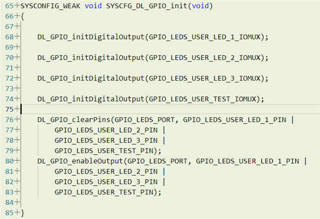

    The .c file has the initialization functions, I typically look at the process flow for creating new instances of peripherals if I need to change configurations in real time.

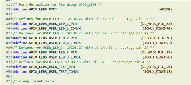

    For the GPIOs you need to initialize how you want the pins (in the SysConfig your 4 GPIOS (PB22, PB27, PB26, PB16) are initialized as Outputs. I believe you should see PB16 set, but PB15 is not initialized in your SysConfig and the Pin 26 and Pin 27 that are initialized are on PortB, not PortA.

       a. How to determine GPIO_PIN and corresponding IOMUX_PINCM? If for example we have DL_GPIO_PIN_22 paired up with IOMUX_PINCM50 - how did we know the number 50? How did we know it corresponds to GPIO 22?
    3. We ARE configuring port A GPIOs and this is not true that we are configuring all our GPIOs on port B. Why is your assumption we're on port B?

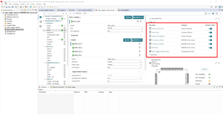

    4. When I "look at SysConfig there is a symbol on the top right <>" (which I've already done and already saw...) why do I see 7 files pop up while you see 4?
        The files are:
