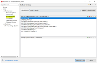

  • HI,
      I will suggest you 'import' one of the stock TivaWare Ethernet examples into CCS. Make sure you import, not copy the example. When you import all the project settings (include paths and library) are also imported. They should build right out of box. The examples will have the stock lwipopts.h file that you can modify to suit your application. The examples can be found at:

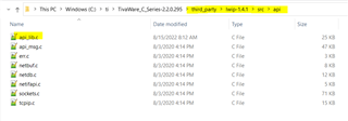

  • Using the enet_lwip example, I miss some files...
    C:/ti/TivaWare_C_Series-2.2.0.295/utils/lwiplib.c", line 49: fatal error: cannot open source file "third_party/lwip-1.4.1/src/api/api_lib.c
    (and indeed, there is no file like that to be found...).
      Did you 'import' the project and have the correct include Options? The api_lib.c file is in third_party/lwip-1.4.1/src/api/api_lib.c but you need to make sure you CCS include Options can search it.
