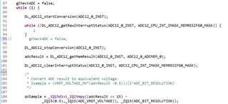

    • The above is obtained by interrupt, whether there is a polling way

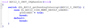

  • Hi RU,
    Refers to the code example of the SDK, the interrupt is used for judge whether ADC conversion is finished:
    If so, just use the interrupt flag judgement in the polling task and you can let it work as expected:
    DL_ADC12_getRawInterruptStatus(ADC12_0_INST, ADC12_CPU_INT_IMASK_MEMRESIFG0_MASK) -> If there is a new conversion data in MEM0, then this function will return a value of "1", or return "0".
    B.R.
    Sal
    • I don't want to use interrupt
    • I put the break point here(after while) and it can't pass
    You make something wrong with your code.
    Below is what I use based on the code example and I test it works well:
    B.R.
    Sal
