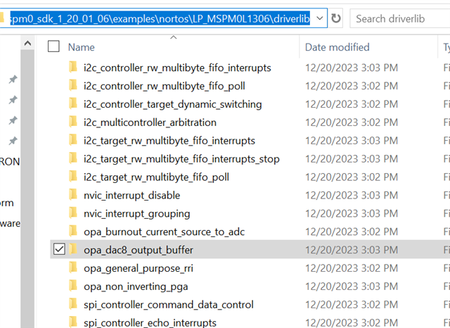

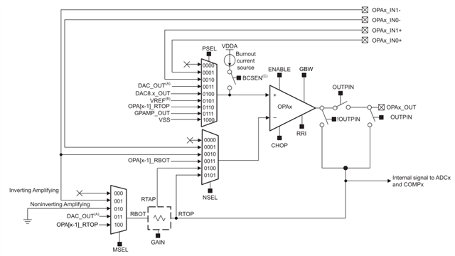

Hi Pradeepkumar,
MSPM0 L-series has no independent DAC module, so we need output COMP.DAC by OPA module. PA16 can be configured as OPA1_OUT, so I think it's OK. You can confirm Pin configuration in the datasheet or SysConfig.
You can refer to the SDK example below:
OPA diagram block for reference:
