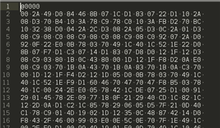

The goal is to migrate from the ARMCC compiler to the TI ARM CLang compiler for an ARM Cortex M0+ device.
The flow used currently for the ARMCC compiler is as follows
  1. Compile all source files into object files
  2. Link them with the arm linker to produce an ELF format file
  3. Input the output from the previous step to the fromelf tool to output a hex32 file that is preloaded into a ROM.
    1. The hex32 file is ROM Size lines in size
    2. Each line is 2x 16-bit thumb instructions
To try and replicate this with the tiarmclang compiler, the sequence is:
  1. Compile all source files into object files. The options used are:
    1. -std=c99
    2. -O3
    3. -g
    4. -c
    5. -mcpu=cortex-m0
    6. -march=thumbv6m
    7. --target=armv6m-ti-none-eabi
  2. To link the options passed are:
    1. -Xlinker --disable_auto_rts
    2. -Xlinker --search_path=$(CLANG_GENERIC_LIB_DIR)
    3. -Xlinker <command file that utilizes the MEMORY and SECTIONS directives>
  3. Pass the output of the previous step to the tiarmhex tool with the following switches:
    1. --byte
    2. --binary
The desired output looks roughly like:
One example of the output I am getting looks like:
I have tried all variations as described on the compiler documentation and I have toyed with the ROMS directive inside of a command file. Nothing I have tried has output a file of word aligned thumb machine code.
Thanks in advance for any feedback.
Edit: I have added a zip file that shows an example of the behavior with armcc and the attempts to make that behavior work with clang.

  • George-
      Thank you for the suggestion. I have attempted what you have said and while the output formatting does match the desired formatting, the contents are questionable. I expect the first line in the output file to be the stack pointer address (hardcoded to 0x200003FC in the example) and the following lines to be the isr vector table. The output does not indicate to me this has occurred and now I question if it's even possible to get raw machine code output from the tiarmclang compiler. Does the tiarmclang compiler support the legacy arm compiler through a switch that I am overlooking?
      Thanks.
    -Austin
  • I expect the first line in the output file to be the stack pointer address (hardcoded to 0x200003FC in the example) and the following lines to be the isr vector table.
    I was unaware of that requirement.  I suppose fromelf works that way.  The first word in the hex dump is the first word in the binary file.  The first word in the binary file is the contents at the lowest initialized address in the executable.
    With all that in mind, I conclude there is no straightforward way to use tools from the tiarmclang toolchain to exactly duplicate the output of fromelf.
