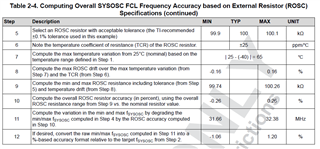

I have a customer who wanted to know if there was a way to calculate the overall system oscillator accuracy with a given rosc tolerance? Is there a spreadsheet or some sort of calculator? I see there's a table in the TRM but that assumes the 0.1% tolerant resistor.
What's the minimum tolerance required to get +/- 2% accuracy?
