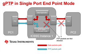

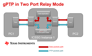

    Another term used for gPTP relay is 'Transparent Clock' as per 1588 spec. Similarly gPTP endpoint are called as 'Ordinary Clock' .
    Please find the details and difference between PTP End points and Relay in the below diagram.
    Please note that, for data path there is NO restriction. It is only that the PTP packets are 'relayed' from one port to another port. Hence, time sync between ICSSG1 and PC2 is NOT possible in gPTP endpoint.
    As you per my understanding about your requirement, you DO NOT need "gPTP in relay mode". Please correct me if my understanding is wrong.
    Thanks and regards,
    Pradeep

          In our application, We need to synchronize the time between one port and one switch (PC1 or PC2)separately ,  in order to support the 802.1qbv feature in future. Therefore, Maybe gPTP in Two Port Relay Mode is what we need.Is it right?
  • Hi Wang,
       Synchronizing only PORT1_ICSSG_Instance0 in end point will synchronize IEP of ICSSG0. This means, even with single PORT End point mode, both the ports of ICSSG_Instance0 shall be able to support 802.1qbv feature. Because, both ports use same IEP timing to 802.1qbv transmission. As you know there is only one IEP per ICSSG Instance.
    The same is explained in the below diagram-
    Please let me know if the above answers clarifies your query.
    Thanks and regards,
    Pradeep
