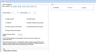

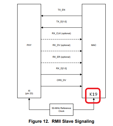

TMS570LC4357: TMS570LC4357: We have adopted the RMII mode circuit design for the Ethernet interface from the TMS570LC4357 HDK development board. However, we are unable to ping the computer host.
Part Number: TMS570LC4357
We are using the official software version v00.04.00, and the configuration in the HCG is as follows:
1、Pin Muxing
2、Input Pin Muxing
3、Special Pin Muxing
4、EMAC Configuration

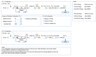

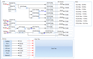

5、VIM Channel 64-95
6、VIM RAM
7、GCM
8、PLL
May I ask if there are any errors in the configuration on the HCG?

My Ethernet configuration on the computer host side is as follows:
IP:192.168.2.43
NETMASK:255.255.255.0
GATEWAY:192.168.2.254
Despite attempting to ping our custom hardware from the computer host, I am unable to establish a successful connection. I cannot identify the cause of the issue.
