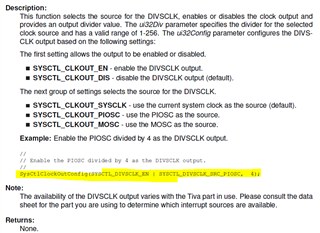

  I'm new to tiva C, I'm trying to enable DIVSCLK .
    I learnt that  I'll need drivers from tivaware to configure GPIO to enable DIVSCLK
MAP_SysCtlClockFreqSet((SYSCTL_XTAL_25MHZ |SYSCTL_OSC_MAIN |SYSCTL_USE_PLL |
SYSCTL_CFG_VCO_480), 120000000);
GPIOPinConfigure(GPIO_PQ4_DIVSCLK);
GPIODirModeSet(GPIO_PORTQ_BASE, GPIO_PIN_4, GPIO_DIR_MODE_HW);
GPIOPadConfigSet(GPIO_PORTQ_BASE, GPIO_PIN_4, GPIO_STRENGTH_2MA, GPIO_PIN_TYPE_STD);
SysCtlClockOutConfig(SYSCTL_CLKOUT_EN | SYSCTL_CLKOUT_SYSCLK, 10);
IN this opuput pin is no responce pin PQ4 .
how to configure and give me a reference code
