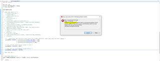

I flashed below code to put ECU in low power mode (snooze)
/** - Setup GCLK, HCLK and VCLK clock source for normal operation, power down mode and after wakeup */
systemREG1->GHVSRC = (uint32)((uint32)SYS_LPO_HIGH << 24U)
| (uint32)((uint32)SYS_LPO_HIGH << 16U)
| (uint32)((uint32)SYS_PLL1 << 0U);
/* turn off all clock sources except LF LPO */
systemREG1->CSDISSET = 0xEF;
/* turn off all clock domains except RTICLK */
systemREG1->CDDISSET = 0xFFBF;
Now ECU is not waking Up at all.
I am getting above error "Unable to access DAP"
what i can do to wake Up ECU again?
Manoraj Selvaraj
Adding information to this issue
I am unable to flash the ECU.
I am getting below error
currently ECU consume around 120mA current.
