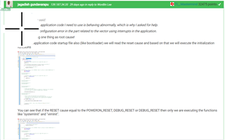

  • Hi Sachin,
    I am suspecting one reason for not working interrupts:
    (+) RM57L843: UART_Bootlader_RM57 Questions - Arm-based microcontrollers forum - Arm-based microcontrollers - TI E2E support forums
    In above thread please refer the below comment:
    Thanks & regards,
    Jagadish.
