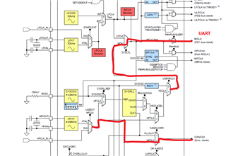

1) we are trying to using sample code of rx signal through can . please tell me can  we  used for sending a  message through any CAN BUS analyzer or need anything proper else  and connection line TX -> RX , RX -> TX or any thing else suggest me .
2) can we used  two different clock for uart and can in same MCU . (  one is internal and another in external ).
