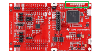

  • Yes, you just program the bin files into the broken XDS110 through JTAG. For the connection, please refer to the LP user guide
  • Thanks again! I was able to find the information about the connection between the two XDS110 probe using the standard JTAG 10-pin cable. Could you please guide me through the reprogramming steps? Or if there is a documentation on it, where can find it?
  • You just use Unilfash to download the bin files into MSP432. The flow is same like programming a MSPM0.

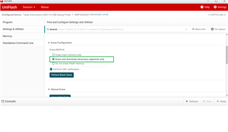

  • Here is the pin you need to connect. SWD is enough. You can refer to the schematic in the LP user's guide.
    You need to download both with this uniflash setting.
    Please do some try. The LP will not get bader.
