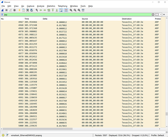

    Wireshark capture:

    Cortex_R5_0: GEL Output: TX_PRI1_MAXLEN_REG             = 0x000007E8
    Cortex_R5_0: GEL Output: TX_PRI2_MAXLEN_REG             = 0x000007E8
    Cortex_R5_0: GEL Output: TX_PRI3_MAXLEN_REG             = 0x000007E8
    Cortex_R5_0: GEL Output: TX_PRI4_MAXLEN_REG             = 0x000007E8
    Cortex_R5_0: GEL Output: TX_PRI5_MAXLEN_REG             = 0x000007E8
    Cortex_R5_0: GEL Output: TX_PRI6_MAXLEN_REG             = 0x000007E8
    Cortex_R5_0: GEL Output: TX_PRI7_MAXLEN_REG             = 0x000007E8
    Cortex_R5_0: GEL Output: P0_CONTROL_REG                 = 0x0002000B
    Cortex_R5_0: GEL Output: P0_FLOW_ID_OFFSET_REG          = 0x00000000
    Cortex_R5_0: GEL Output: P0_BLK_CNT_REG                 = 0x00000001
    Cortex_R5_0: GEL Output: P0_PORT_VLAN_REG               = 0x00000000
    Cortex_R5_0: GEL Output: P0_TX_PRI_MAP_REG              = 0x76543210
    Cortex_R5_0: GEL Output: P0_PRI_CTL_REG                 = 0x00000000
    Cortex_R5_0: GEL Output: P0_RX_PRI_MAP_REG              = 0x76543210
    Cortex_R5_0: GEL Output: P0_RX_MAXLEN_REG               = 0x000005EE
    Cortex_R5_0: GEL Output: P0_TX_BLKS_PRI_REG             = 0x01245678
    Cortex_R5_0: GEL Output: P0_IDLE2LPI_REG                = 0x00000000
    Cortex_R5_0: GEL Output: P0_LPI2WAKE_REG                = 0x00000000
    Cortex_R5_0: GEL Output: P0_EEE_STATUS_REG              = 0x00000060
    Cortex_R5_0: GEL Output: P0_RX_PKTS_PRI_REG             = 0x00000000
    Cortex_R5_0: GEL Output: P0_RX_GAP_REG                  = 0x00000000
    Cortex_R5_0: GEL Output: P0_FIFO_STATUS_REG             = 0x00000000
    Cortex_R5_0: GEL Output: P0_RX_DSCP_MAP_REG_y           = 0x00000000
    Cortex_R5_0: GEL Output: P0_PRI_CIR_REG_y               = 0x00000000
    Cortex_R5_0: GEL Output: P0_PRI_EIR_REG_y               = 0x00000000
    Cortex_R5_0: GEL Output: P0_TX_D_THRESH_SET_L_REG       = 0x1F1F1F1F
    Cortex_R5_0: GEL Output: P0_TX_D_THRESH_SET_H_REG       = 0x1F1F1F1F
    Cortex_R5_0: GEL Output: P0_RX_D_THRESH_CLR_L_REG       = 0x00000000
    Cortex_R5_0: GEL Output: P0_RX_D_THRESH_CLR_H_REG       = 0x00000000
    Cortex_R5_0: GEL Output: P0_TX_G_BUF_THRESH_SET_L_REG   = 0x1F1F1F1F
    Cortex_R5_0: GEL Output: P0_TX_G_BUF_THRESH_SET_H_REG   = 0x1F1F1F1F
    Cortex_R5_0: GEL Output: P0_TX_G_BUF_THRESH_CLR_L_REG   = 0x00000000
    Cortex_R5_0: GEL Output: P0_TX_G_BUF_THRESH_CLR_H_REG   = 0x00000000
    Cortex_R5_0: GEL Output: P0_SRC_ID_A_REG                = 0x04030201
    Cortex_R5_0: GEL Output: P0_SRC_ID_B_REG                = 0x08070605
    Cortex_R5_0: GEL Output: P0_HOST_BLKS_PRI_REG           = 0x00000000
    Cortex_R5_0: GEL Output: PN_RESERVED_REG                = 0x00000000
    Cortex_R5_0: GEL Output: PN_CONTROL_REG                 = 0x00000000
    Cortex_R5_0: GEL Output: PN_MAX_BLKS_REG                = 0x00001004
    Cortex_R5_0: GEL Output: PN_BLK_CNT_REG                 = 0x00000001
    Cortex_R5_0: GEL Output: PN_PORT_VLAN_REG               = 0x00000000
    Cortex_R5_0: GEL Output: PN_TX_PRI_MAP_REG              = 0x76543210
    Cortex_R5_0: GEL Output: PN_PRI_CTL_REG                 = 0x00009000
    Cortex_R5_0: GEL Output: PN_RX_PRI_MAP_REG              = 0x76543210
    Cortex_R5_0: GEL Output: PN_RX_MAXLEN_REG               = 0x000005EE
    Cortex_R5_0: GEL Output: PN_TX_BLKS_PRI_REG             = 0x01245678
    Cortex_R5_0: GEL Output: PN_RX_FLOW_THRESH_REG          = 0x00000000
    Cortex_R5_0: GEL Output: PN_IDLE2LPI_REG                = 0x00000000
    Cortex_R5_0: GEL Output: PN_LPI2WAKE_REG                = 0x00000000
    Cortex_R5_0: GEL Output: PN_EEE_STATUS_REG              = 0x00000062
    Cortex_R5_0: GEL Output: PN_FIFO_STATUS_REG             = 0x0000FF00
    Cortex_R5_0: GEL Output: PN_EST_CONTROL_REG             = 0x00000000
    Cortex_R5_0: GEL Output: PN_RX_DSCP_MAP_REG_y           = 0x00000000
    Cortex_R5_0: GEL Output: PN_PRI_CIR_REG_y               = 0x00000000
    Cortex_R5_0: GEL Output: PN_PRI_EIR_REG_y               = 0x00000000
    Cortex_R5_0: GEL Output: PN_TX_D_THRESH_SET_L_REG       = 0x1F1F1F1F
    Cortex_R5_0: GEL Output: PN_TX_D_THRESH_SET_H_REG       = 0x1F1F1F1F
    Cortex_R5_0: GEL Output: PN_TX_D_THRESH_CLR_L_REG       = 0x00000000
    Cortex_R5_0: GEL Output: PN_TX_D_THRESH_CLR_H_REG       = 0x00000000
    Cortex_R5_0: GEL Output: PN_TX_G_BUF_THRESH_SET_L_REG   = 0x1F1F1F1F
    Cortex_R5_0: GEL Output: PN_TX_G_BUF_THRESH_SET_H_REG   = 0x1F1F1F1F
    Cortex_R5_0: GEL Output: PN_TX_G_BUF_THRESH_CLR_L_REG   = 0x00000000
    Cortex_R5_0: GEL Output: PN_TX_G_BUF_THRESH_CLR_H_REG   = 0x00000000
    Cortex_R5_0: GEL Output: PN_TX_D_OFLOW_ADDVAL_L_REG     = 0x00000000
    Cortex_R5_0: GEL Output: PN_TX_D_OFLOW_ADDVAL_H_REG     = 0x00000000
    Cortex_R5_0: GEL Output: PN_SA_L_REG                    = 0x00000000
    Cortex_R5_0: GEL Output: PN_SA_H_REG                    = 0x00000000
    Cortex_R5_0: GEL Output: PN_TS_CTL_REG                  = 0x00000000
    Cortex_R5_0: GEL Output: PN_TS_SEQ_LTYPE_REG            = 0x001E0000
    Cortex_R5_0: GEL Output: PN_TS_VLAN_LTYPE_REG           = 0x00000000
    Cortex_R5_0: GEL Output: PN_TS_CTL_LTYPE2_REG           = 0x00000000
    Cortex_R5_0: GEL Output: PN_TS_CTL2_REG                 = 0x00040000
    Cortex_R5_0: GEL Output: PN_MAC_CONTROL_REG             = 0x00000000
    Cortex_R5_0: GEL Output: PN_MAC_STATUS_REG              = 0xD0000000
    Cortex_R5_0: GEL Output: PN_MAC_SOFT_RESET_REG          = 0x00000000
    Cortex_R5_0: GEL Output: PN_MAC_BOFFTEST_REG            = 0x00DD0000
    Cortex_R5_0: GEL Output: PN_MAC_RX_PAUSETIMER_REG       = 0x00000000
    Cortex_R5_0: GEL Output: PN_MAC_RXN_PAUSETIMER_REG_y    = 0x00000000
    Cortex_R5_0: GEL Output: PN_MAC_TX_PAUSETIMER_REG       = 0x00000000
    Cortex_R5_0: GEL Output: PN_MAC_TXN_PAUSETIMER_REG_y    = 0x00000000
    Cortex_R5_0: GEL Output: PN_MAC_EMCONTROL_REG           = 0x00000000
    Cortex_R5_0: GEL Output: PN_MAC_TX_GAP_REG              = 0x0000000C
    Cortex_R5_0: GEL Output: FETCH_LOG_y (skipped)
    Cortex_R5_0: GEL Output: ------------------------------------
    Cortex_R5_0: GEL Output: RXGOODFRAMES                   = 0x00000000
    Cortex_R5_0: GEL Output: RXBROADCASTFRAMES              = 0x00000000
    Cortex_R5_0: GEL Output: RXMULTICASTFRAMES              = 0x00000000
    Cortex_R5_0: GEL Output: RXCRCERRORS                    = 0x00000000
    Cortex_R5_0: GEL Output: RXOVERSIZEDFRAMES              = 0x00000000
    Cortex_R5_0: GEL Output: RXUNDERSIZEDFRAMES             = 0x00000000
    Cortex_R5_0: GEL Output: RXFRAGMENTS                    = 0x00000000
    Cortex_R5_0: GEL Output: ALE_DROP                       = 0x00000000
    Cortex_R5_0: GEL Output: ALE_OVERRUN_DROP               = 0x00000000
    Cortex_R5_0: GEL Output: RXOCTETS                       = 0x00000000
    Cortex_R5_0: GEL Output: TXGOODFRAMES                   = 0x00000000
    Cortex_R5_0: GEL Output: TXBROADCASTFRAMES              = 0x00000000
    Cortex_R5_0: GEL Output: TXMULTICASTFRAMES              = 0x00000000
    Cortex_R5_0: GEL Output: TXOCTETS                       = 0x00000000
    Cortex_R5_0: GEL Output: OCTETFRAMES64                  = 0x00000000
    Cortex_R5_0: GEL Output: OCTETFRAMES65T127              = 0x00000000
    Cortex_R5_0: GEL Output: OCTETFRAMES128T255             = 0x00000000
    Cortex_R5_0: GEL Output: OCTETFRAMES256T511             = 0x00000000
    Cortex_R5_0: GEL Output: OCTETFRAMES512T1023            = 0x00000000
    Cortex_R5_0: GEL Output: OCTETFRAMES1024TUP             = 0x00000000
    Cortex_R5_0: GEL Output: NETOCTETS                      = 0x00000000
    Cortex_R5_0: GEL Output: RX_BOTTOM_OF_FIFO_DROP         = 0x00000000
    Cortex_R5_0: GEL Output: PORTMASK_DROP                  = 0x00000000
    Cortex_R5_0: GEL Output: RX_TOP_OF_FIFO_DROP            = 0x00000000
    Cortex_R5_0: GEL Output: ALE_RATE_LIMIT_DROP            = 0x00000000
    Cortex_R5_0: GEL Output: ALE_VID_INGRESS_DROP           = 0x00000000
    Cortex_R5_0: GEL Output: ALE_DA_EQ_SA_DROP              = 0x00000000
    Cortex_R5_0: GEL Output: ALE_BLOCK_DROP                 = 0x00000000
    Cortex_R5_0: GEL Output: ALE_SECURE_DROP                = 0x00000000
    Cortex_R5_0: GEL Output: ALE_AUTH_DROP                  = 0x00000000
    Cortex_R5_0: GEL Output: ALE_UNKN_UNI                   = 0x00000000
    Cortex_R5_0: GEL Output: ALE_UNKN_UNI_BCNT              = 0x00000000
    Cortex_R5_0: GEL Output: ALE_UNKN_MLT                   = 0x00000000
    Cortex_R5_0: GEL Output: ALE_UNKN_MLT_BCNT              = 0x00000000
    Cortex_R5_0: GEL Output: ALE_UNKN_BRD                   = 0x00000000
    Cortex_R5_0: GEL Output: ALE_UNKN_BRD_BCNT              = 0x00000000
    Cortex_R5_0: GEL Output: ALE_POL_MATCH                  = 0x00000000
    Cortex_R5_0: GEL Output: ALE_POL_MATCH_RED              = 0x00000000
    Cortex_R5_0: GEL Output: ALE_POL_MATCH_YELLOW           = 0x00000000
    Cortex_R5_0: GEL Output: TX_MEMORY_PROTECT_ERROR        = 0x00000000
    Cortex_R5_0: GEL Output: RXPAUSEFRAMES                  = 0x00000000
    Cortex_R5_0: GEL Output: RXALIGNCODEERRORS              = 0x00000000
    Cortex_R5_0: GEL Output: RXJABBERFRAMES                 = 0x00000000
    Cortex_R5_0: GEL Output: TXPAUSEFRAMES                  = 0x00000000
    Cortex_R5_0: GEL Output: TXDEFERREDFRAMES               = 0x00000000
    Cortex_R5_0: GEL Output: TXCOLLISIONFRAMES              = 0x00000000
    Cortex_R5_0: GEL Output: TXSINGLECOLLFRAMES             = 0x00000000
    Cortex_R5_0: GEL Output: TXMULTCOLLFRAMES               = 0x00000000
    Cortex_R5_0: GEL Output: TXEXCESSIVECOLLISIONS          = 0x00000000
    Cortex_R5_0: GEL Output: TXLATECOLLISIONS               = 0x00000000
    Cortex_R5_0: GEL Output: RXIPGERROR                     = 0x00000000
    Cortex_R5_0: GEL Output: TXCARRIERSENSEERRORS           = 0x00000000
    Cortex_R5_0: GEL Output: ENET_PN_TX_PRI_REG_y           = 0x00000000
    Cortex_R5_0: GEL Output: ENET_PN_TX_PRI_BCNT_REG_y      = 0x00000000
    Cortex_R5_0: GEL Output: ENET_PN_TX_PRI_DROP_REG_y      = 0x00000000
    Cortex_R5_0: GEL Output: ENET_PN_TX_PRI_DROP_BCNT_REG_y = 0x00000000
    Cortex_R5_0: GEL Output: IDVER_REG                      = 0x4E8A010C
    Cortex_R5_0: GEL Output: CONTROL_REG                    = 0x00020025
    Cortex_R5_0: GEL Output: RFTCLK_SEL_REG                 = 0x00000000
    Cortex_R5_0: GEL Output: TS_PUSH_REG                    = 0x00000000
    Cortex_R5_0: GEL Output: TS_LOAD_VAL_REG                = 0x00000000
    Cortex_R5_0: GEL Output: TS_LOAD_EN_REG                 = 0x00000000
    Cortex_R5_0: GEL Output: TS_COMP_VAL_REG                = 0x00000000
    Cortex_R5_0: GEL Output: TS_COMP_LEN_REG                = 0x00000000
    Cortex_R5_0: GEL Output: INTSTAT_RAW_REG                = 0x00000000
    Cortex_R5_0: GEL Output: INTSTAT_MASKED_REG             = 0x00000000
    Cortex_R5_0: GEL Output: INT_ENABLE_REG                 = 0x00000001
    Cortex_R5_0: GEL Output: TS_COMP_NUDGE_REG              = 0x00000000
    Cortex_R5_0: GEL Output: EVENT_POP_REG                  = 0x00000000

  • I do see both lights on the RJ45 connector on the ControlCard. The left light is amber (1000BASE-T) and the right light flashes green when I send a packet. This seems like some kind of software config. issue, but I'm not finding any obvious cause.
  • Output from Scripts -> CPSW Statistics Print -> cpsw_3g_statsprint_nonzero (after running example and sending packets):
    Cortex_R5_0: GEL Output:           STATS
    Cortex_R5_0: GEL Output:           PORT0 STATS
    Cortex_R5_0: GEL Output:           PORT1 STATS
    Cortex_R5_0: GEL Output:           PORT2 STATS
  • Finally figured it out. SW15 on the ControlCard was in the wrong position.
    It seems SW15 was installed in the opposite orientation of SW14 and SW16. This means that SW14/16 had to be in the "down" position (off), but SW15 has to be in the "UP" position (off).
    Now getting statistics as expected:
