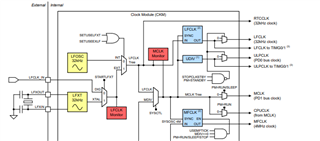

Hi Jerry
Yes. RTC can use LFOSC (interal oscillator) as the clock source. Please check the accuracy of LFOSC which is 3% at -40~85C.
