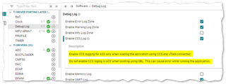

In the SYSCONFIG file under 'Enable CCS Log' it mentions an A53 processor:
Is this still applicable for AM2634 and AM263P4 please?
Thank you.
This is not applicable for AM2634 and AM263P4 as there is no A53 core present. We will take note to remove this in future releases of sysconfig.
