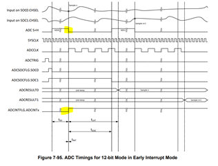

    2. As per AM263x_TRM_NOV_2022.pdf ,
    Interrupt is generating after the first sample and hold time. see the highlighted portion in attached image.
    But in our discussion, you confirmed that interrupt is generating after sample and hold time of SOC5. Could you please clarify this image?

  • Hi Aswathy,
    I can answer this one immediately. The figure you've shared is for Early Interrupt mode.
    However you've said the following:
    Since it is a synchronized conversion, interrupt will be generated at the end of acquisition window of SOC5
    Based on this, I am expecting that the configuration used would be based on late interrupt mode which is the normal usage for most applications:
    This is the setting used in our examples except the dedicated early interrupt example:

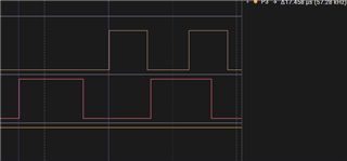

  • Hi Ralph,
    In my configuration, interrupt is configured to generate at the end of acquisition window. This is the reason why I expect the interrupt to be at the end of acquisition window of 5th SOC , since I have 6 channels in my ADC unit.
    1. Could you please confirm, when will be the interrupt generation (3 adc units with same hardware trigger and each contains 6 channels with same sample window as mentioned in the earlier post)?
    2. During testing, I have used 20khz PWM for generating interrupt. and interrupt is generating in the low to high transition. at the begining ADC iSR is generating after 5 to 7 us.  but after some time, it takes 14us to 17us to generate ADC ISR.after that i am not getting any ADC ISR.
    Why this conversion time shows differences from 7us to 17us.?
    In below image, first image shows ADC ISR routine and second shows pwm. The difference shows the time required to generate ADC ISR
    Please comment.

  • Hi Aswathy,
    I've been reviewing the information in the previous posts.
    I have a few questions/comments.
    1. Can you provide the EPWM Trigger configuration and ADC SOC configuration code you are using?
    2. Have you reviewed the ADC Multiple SOC EPWM example in the latest SDK? (See EXAMPLES_DRIVERS_ADC_MULTIPLE_SOC_EPWM)
    3. Have you verified that there are no overflows by checking the ADCINTOVF and ADCSOCOVF1 registers?
    4. What are you using for VREF?
    5. What kind of circuit is being used to drive the ADC input? Have you modeled your signal conditioning circuit to determine the optimum acquisition sample size based on the drive strength of the input circuit? Please refer to the information provided in this app note (SPRACT6).
    6. One thing to try is to use 2 available GPIO pins and for both the EPWM ISR and ADC ISR, toggle the signal ON at the beginning of the ISR and OFF before leaving the ISR. This will give you some insight into the time taken for each ISR. Also please verify that there are no interrupt overflows by checking the ADCINTOVF and ADCSOCOVF1 registers.
    If you have a consistent EPWM trigger and aren't changing the S+H time, I don't understand why the interrupt ISR generation time would change as you've mentioned above. Please provide feedback and we will continue to look into this issue.
    Zackary Fleenor

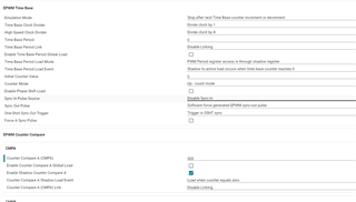

  • Hello Fleenor,
    For ADC - Configuration is generated from EB Mcal configuration and we are using Mcal Autosar code for testing. Configured with EPWM0 hardware trigger in ADC0, ADC1 and ADC2.
    PWM- Configuration is as follows
    EPWM_setTimeBasePeriod(CONFIG_EPWM0_BASE_ADDR, 1000);
    EPWM_setTimeBaseCounterMode(CONFIG_EPWM0_BASE_ADDR, EPWM_COUNTER_MODE_UP);
    EPWM_clearEventTriggerInterruptFlag(CONFIG_EPWM0_BASE_ADDR);
    /* Enable event counter init for SOCA */
    EPWM_enableADCTriggerEventCountInit(CONFIG_EPWM0_BASE_ADDR, EPWM_SOC_A);
    /* Set the event counter init value to 0 */
    EPWM_setADCTriggerEventCountInitValue(CONFIG_EPWM0_BASE_ADDR, EPWM_SOC_A, 0);
    /* Force the event counter init value to event counter */
    EPWM_forceADCTriggerEventCountInit(CONFIG_EPWM0_BASE_ADDR, EPWM_SOC_A);
    EPWM_clearADCTriggerFlag(CONFIG_EPWM0_BASE_ADDR, EPWM_SOC_A);
    EPWM_enableADCTrigger(CONFIG_EPWM0_BASE_ADDR, EPWM_SOC_A);
    EPWM_setADCTriggerSource(CONFIG_EPWM0_BASE_ADDR, EPWM_SOC_A, EPWM_SOC_TBCTR_ZERO, EPWM_SOC_TBCTR_ZERO);
    EPWM_setADCTriggerEventPrescale(CONFIG_EPWM0_BASE_ADDR, EPWM_SOC_A, 1);
