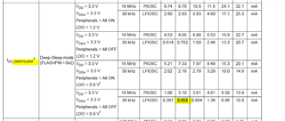

EK-TM4C1294XL: Cannot achieve the datasheet minimum device current
Part Number: EK-TM4C1294XL
I am currently using the example project for the TI TIVA evaluation board and one of the things I am experimenting with is sleep mode current.  According to the datasheet:
  • At room temperature
  • With Vdd and VDDA set to 3.3V
  • With all peripherals off
  • and with LDO voltage set to 0.9V
  • and with the device running on the 30kHz LFIOSC
I should be able to achieve a device current of 0.454mA.
To measure the device current, I have removed the jumper from JP2 on the evaluation board and have placed a meter in series at this jumper.  This allows me to measure current from the +3V3 net to the VDD and VDDA pins on the microprocessor.  So I should only be measuring the sleep current of the microprocessor itself and not the rest of the board.
The sleep mode example software uses a UART, 4 LEDs, a push button, a timer (when the device is running), and a PWM module (when the device is in deep sleep).  I have commented out all the code for the LEDs, the timer, and the PWM module.  I have changed the deep sleep mode LDO voltage setting to 0.9V (and I measure 0.88V to confirm).  I have left the push button enabled for convenience, so that I can still easily control when the device is in deep sleep mode.
I would expect to have a current draw in deep sleep mode close to the datasheet value, but instead I measure 3.95mA (about 8x what is expected).
I will attach my modified source file from the sleep mode example.
Can you tell me what I need to do to achieve the datasheet 0.454mA current draw?

      I have a few comments.
      - The 0.454mA is for deep-sleep mode, not sleep mode. I just want to make sure we are on the same page because you mentioned sleep mode current.
     - What do you measure for deep sleep mode when you run the stock example without modification?
     - Do you have the debugger disconnected when you run the code? Please make sure you disconnect the debugger. There is below note in the datasheet.

  • Hello Charles,
    Yes I am trying to use Deep Sleep mode.
    If I run the stock example without modification, I measure 7mA in deep sleep mode, but the LDO is set to 1.10V instead of 0.9V in the stock example code and there are several lit LEDs in the stock example as well.
    I am not using the debugger.  The code is just running and I have a current meter set up to measure the current into the microprocessor as described.
    The ISR only occurs when the button is pressed.  I press the button to get the device into Deep Sleep mode and then let it sit while I take a current measurement.
    I noticed a footnote for the current table that states "e. To achieve the lowest possible Deep-Sleep current, one or more wait states must be configured in the MEMTIM0 register. If there are no wait states applied in Run mode, then lowest possible Deep-Sleep current is not achieved."  I think this is the piece that I am missing, but I do not have a good example for how to set one of these wait states.  See screenshot below.

  • Hello Charles,
    I followed that thread and saw a couple of suggestions that I could try:
    • Changing the frequency set in CtlClockFreqSet to >16MHz so that MEMTIM0 is set.  This did not change my observed Deep Sleep current.
    • Changing the divisor in SysCtlDeepSleepClockConfigSet from "1" to div_64 or div_63.  This also did not change my observed Deep Sleep current.
    I have downloaded the project shared in that thread, but I have not tried it on my device yet.

  • Hello Charles,
    I managed to get Amit's project running.  When I run Amit's project, VDDC is set to 0.9V and the current draw by the microprocessor is 1.13mA.  This is a lot closer, but still double the datasheet minimum of 0.454mA.
    When I run my project and press the pushbutton to get into Deep Sleep mode, VDDC is set to 0.9V and the current draw from the microprocessor is 5.427mA.
    Amit's code is a step in the right direction, but I am still unable to achieve the minimum current.
